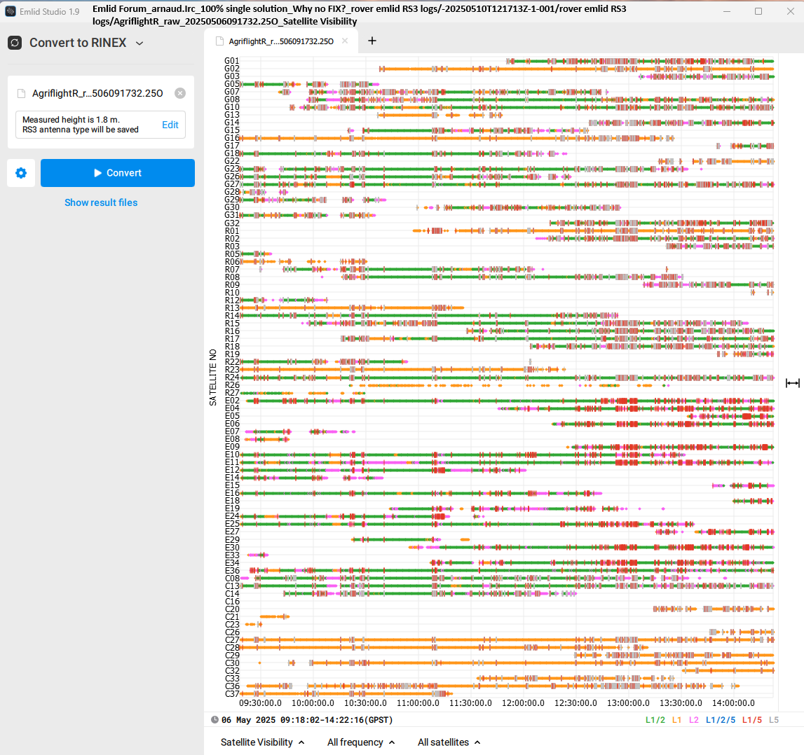

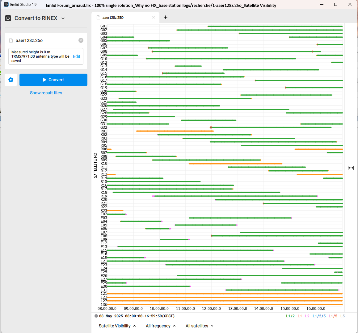

Hi, I took a quick look into your files using Emlid Studio and it appears to me that your Base and Rover timelines do not overlap like the previous members had suspected.
Base = 08 May 2025 08:00:00 - 16:59:59 (GPST)
Rover = 06 May 2025 09:18:02 - 14:22:16 (GPST)
I would download the appropriate Base data and try again.
Though you definitely have some noise going on in your Rover data that might effect your results when you reprocess the data.
