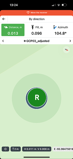

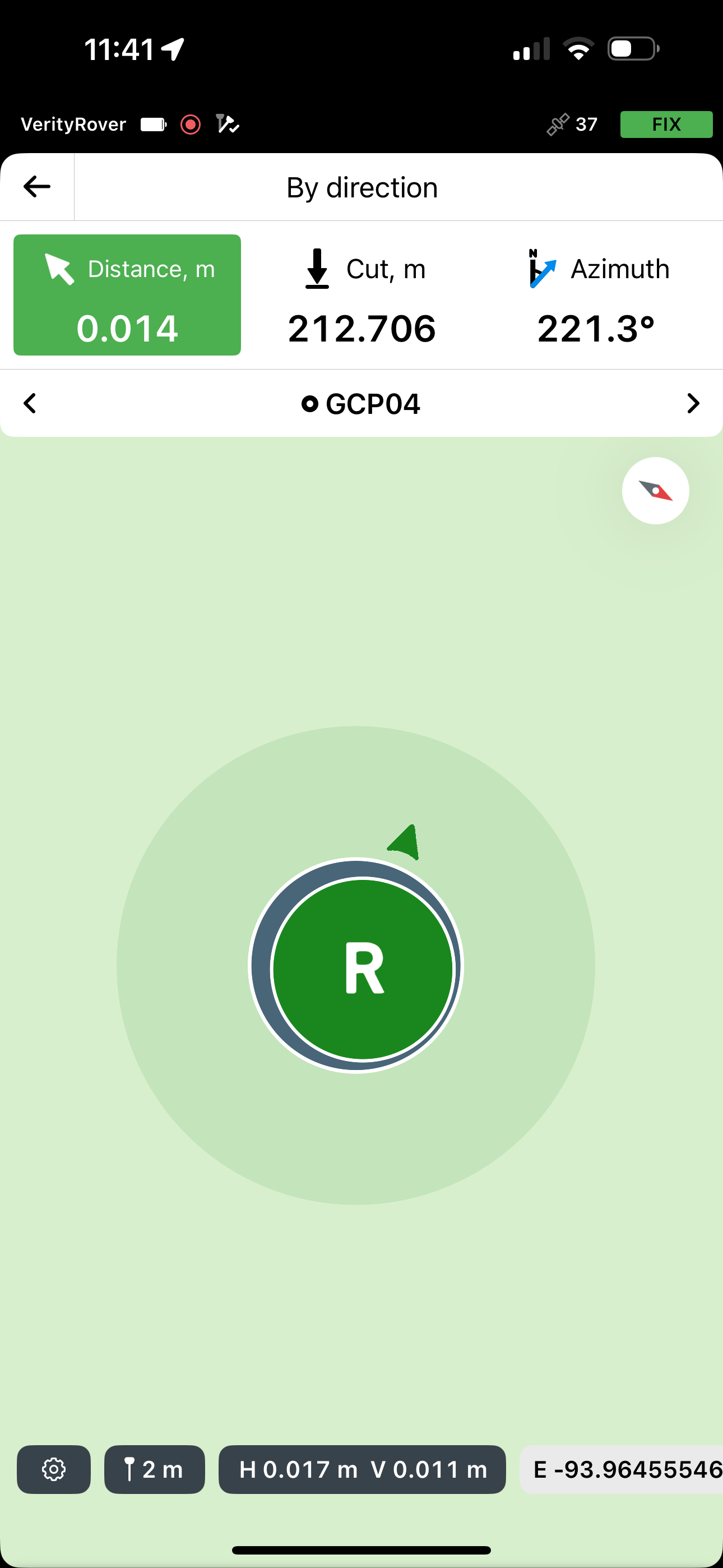

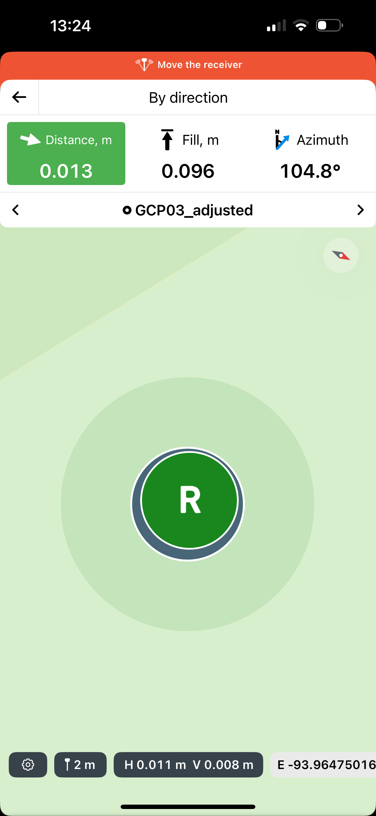

Finally, went back out with ellipsoid height set to a reasonable value, and still am seeing this (no button to save the point). Note that while the screenshot does show that the IMU needs to be recalibrated, in my experience this made no difference. It was just quite difficult to get the screenshot at just the right time!
I’m noticing now that I don’t even get the save button to appear at the bottom of the screen when the point does turn green.
My rough coordinate was specified with an ellipsoid height of 0 m, hence the elevation delta of over 200 m. Perhaps this has to be closer before it can be saved? I’ll try manually adjusting the expected elevation to see if it makes a difference.

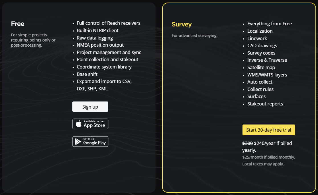

Do you have an active survey plan. You cant save points in stakeout mode without one. If you do have one then resync your account
@adnaanparker1 Well, that’s embarrassing! I had read the documentation as the Survey Plan was required to run the stakeout report, but I had been under the impression that I could still save the points without it. I just saw the note that mentions points cannot be saved without a plan and saw that I also would have had issues due to the projection being in global coordinates, not local.
Could be that I got confused here, where “Point collection and stakeout” is listed in the Free column and “Stakeout reports” is in the Survey column. I wonder if it changed at some point along the way. Regardless, doesn’t change the answer. Thanks @michaelL and @adnaanparker1 for the pointers.
So essentially you are just using stakeout to get you close to a predetermined GCP/CHX location. Just hop out of stakeout mode and collect the point regularly. Stakeout mode is meant for high-accuracy staking of points and then providing a daily report of what the crews actually set. I do like the idea of being able to adjust the tolerance but there does need to be a tolerance. If their design is to make sure the stakeout is accurate to within industry standards I would say that the crews should be trusted to set stakes properly and the report can QC their work if needed.
Hi Brad,
I see that the question has already been cleared up. Thanks to everyone! Yes, you can collect and stake out points. But to save that staked-out point, you’ll need the Survey plan.
