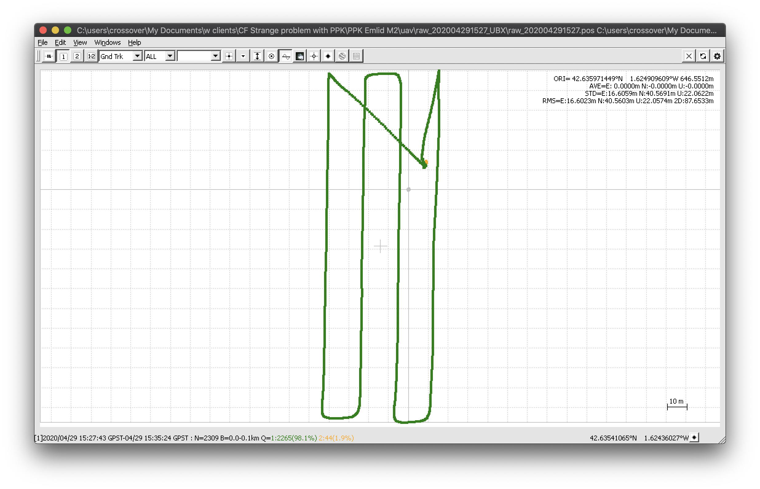

I’ve got the following results after post-processing your files with the RTKLib QT apps:
  • the time-marks
