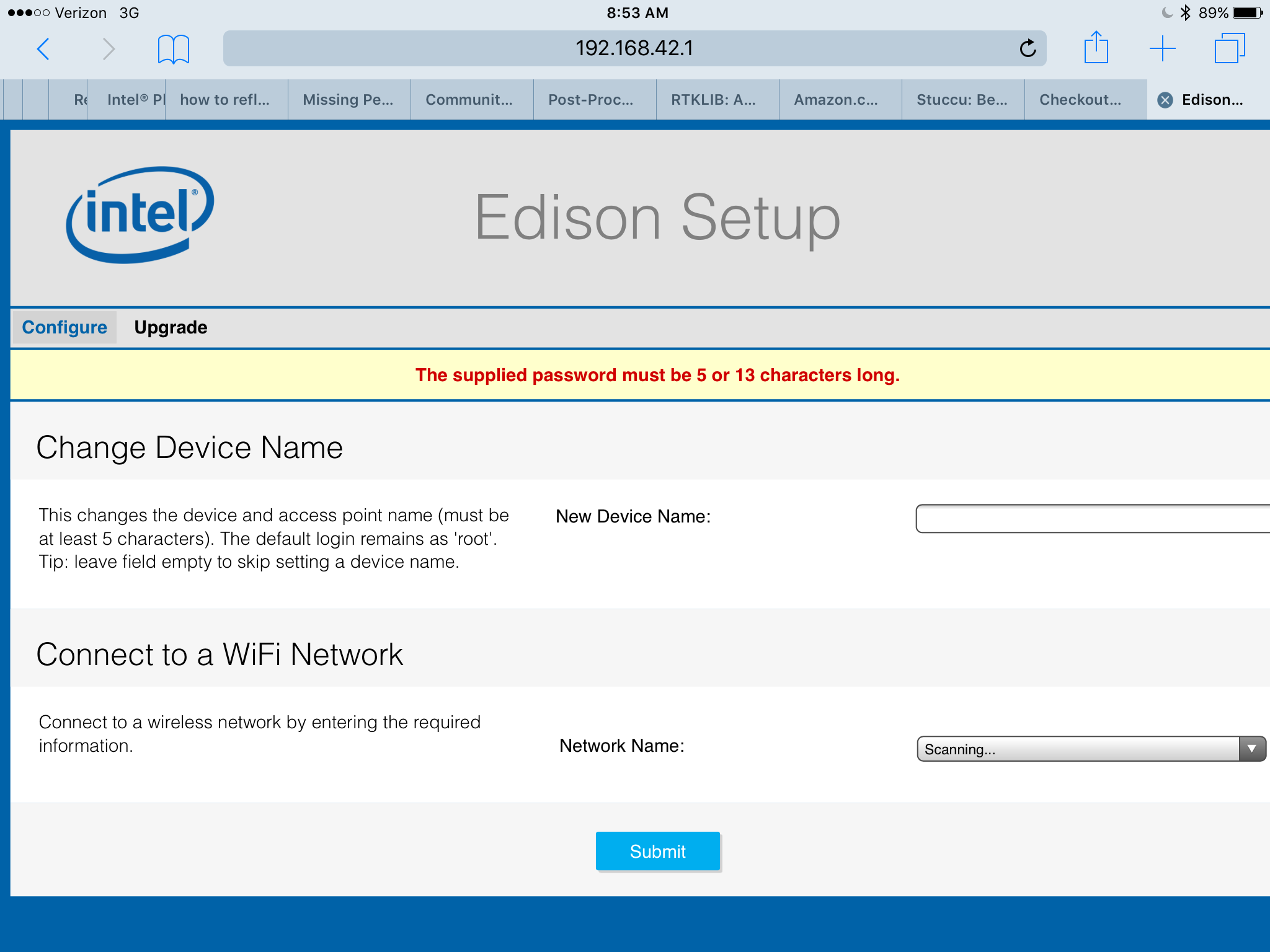

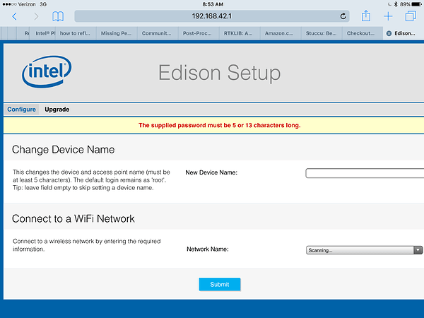

  10. Submit button was pressed
  11. The progress bar came with notification that password need to be 5-13 characters. Mine is 10 numbers. It was yellow.
  12. When that notice went away the Network box showed “Scanning”

I powered on the reach again this morning and this time used my home Wifi connection. And the same thing happened. This is a screenshot of what I am seeing which is identical to what happened last night. The WEP password is 10 digits (all numbers) so it is a mystery why the warning pops up in yellow. I assume the yellow strip is the progress bar.
How would you recommend that I proceed?

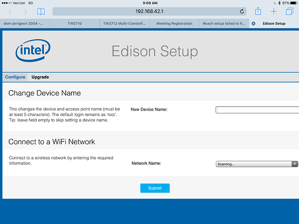

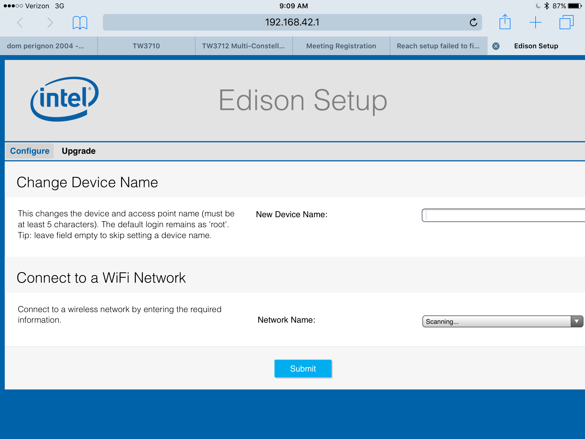

  10. Had to power down my iPad because the Edison Connect to WiFi network network came up as “Scanning” (See screenshot in post above)
  11. Cleared all previous attempts from browser.
  12. At this point when the ipad found the second reach the Edison Connect to WiFi screen showed a configuration where the Network data could be entered.

The installation was a little glitchy for both devices because the Edison setup seemed to get stuck scanning, making it a little hard to get it back the place where I could input the network name, type and password. You might add your experience on how to correct this the quickest way.
