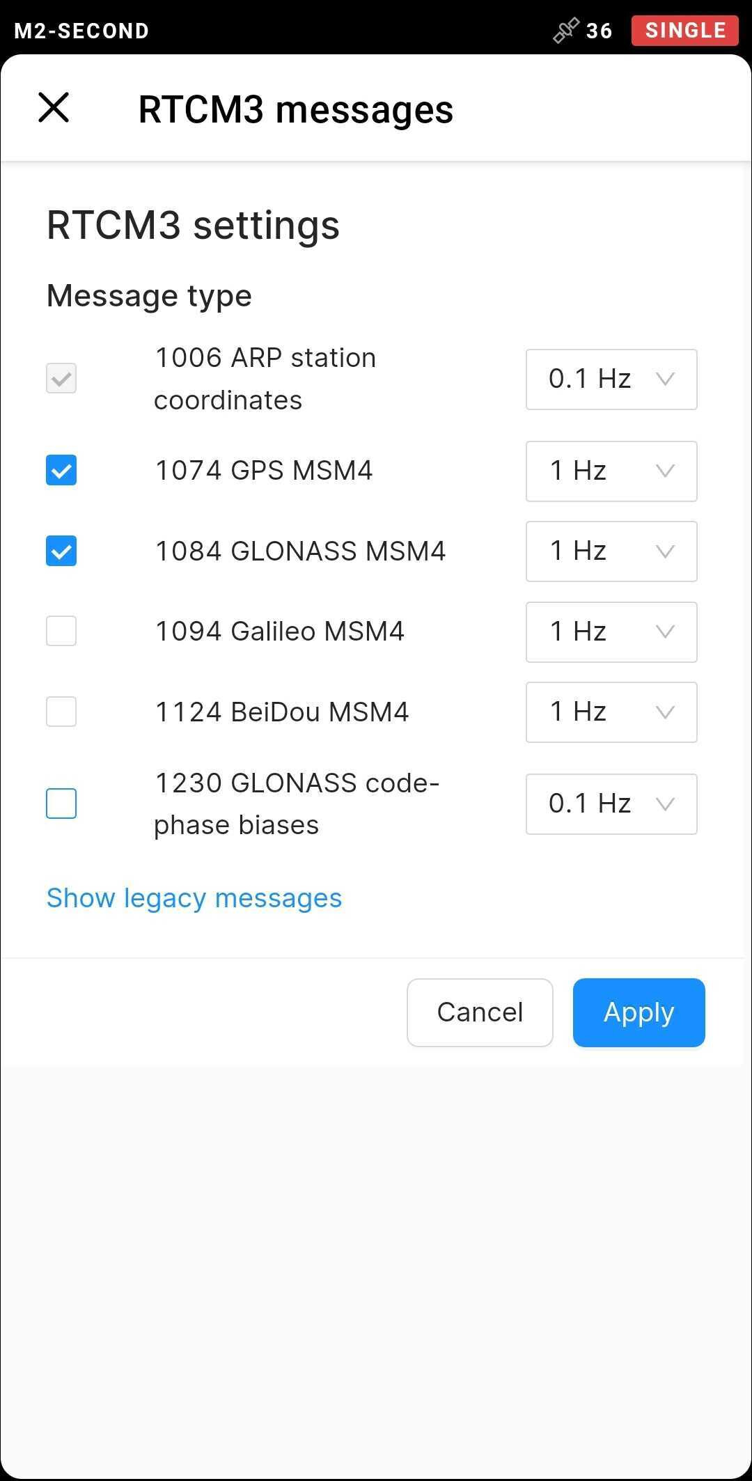

LoRa radio is quite sensitive to obstacles like dense forests or terrain differences. It requires a direct line of sight for better performance. So no wonder that the LoRa range decreases in such environmental conditions.
However, you can reduce the air data rate to increase the LoRa range. This can be done by switching off particular RTCM3 messages in the RTCM3 settings as shown below:
But this approach is good for open fields because without Galileo and Beidou observations it’d be harder to get FIX in the conditions you work in.
