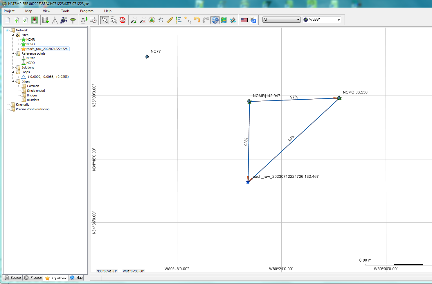

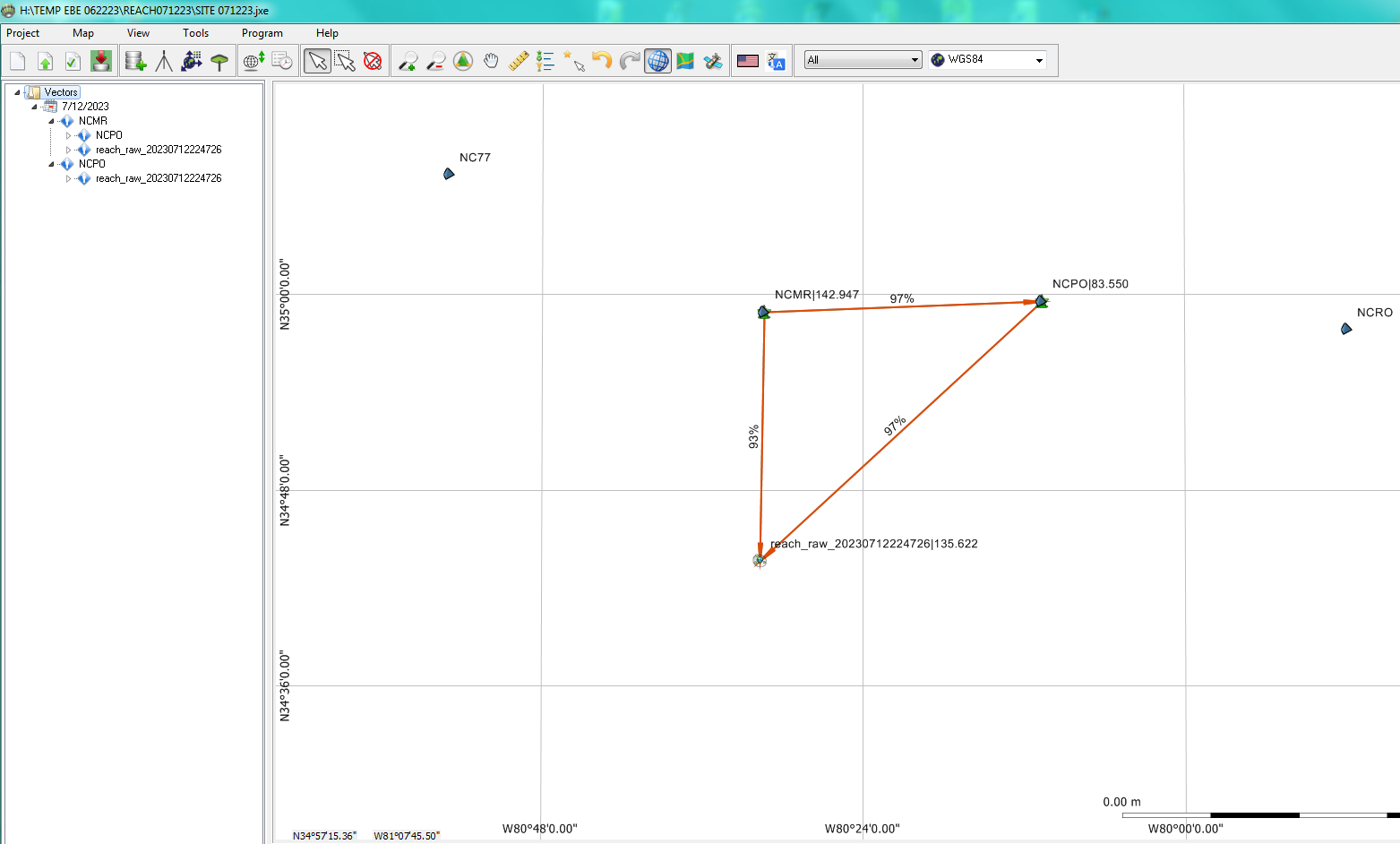

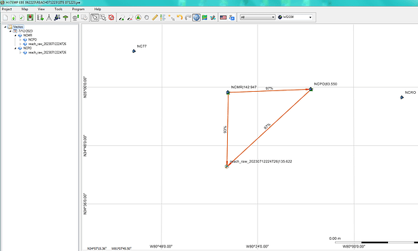

Here you go Mark. 1 hour observation with the default OPUS (GPS only @ 30 sec epochs) setting using RS2 receiver and PP using Javad Justin 3 version 1.80.21(03/16/22)

I didn’t think to locate with the RTN. I was helping my wife feed her rescue horses and wanted to get it setup before the UTC day changed for a 1 hour observation. I’ve had problems with processing Emlid’s rinex when observations cross over into the next day. No problem with the Javad receivers.
I’ll submit to OPUS (if it accepts it) today to see how the comparison is. I don’t use OPUS much… it’s too damn picky with the data quality. I can usually PP the data in less than 5 minutes with Justin 3.
You’ll like Justin 3. In my opinion the Justin engine is far superior than OPUS. It’s the same engine in the Triumph LS if you have the RTPK option; I would highly recommend buying if you’ll be using the LS in the woods like we do. It’s a good check on a questionable fix real-time if needed. I think the cost is about $1K, well worth the cost for us.

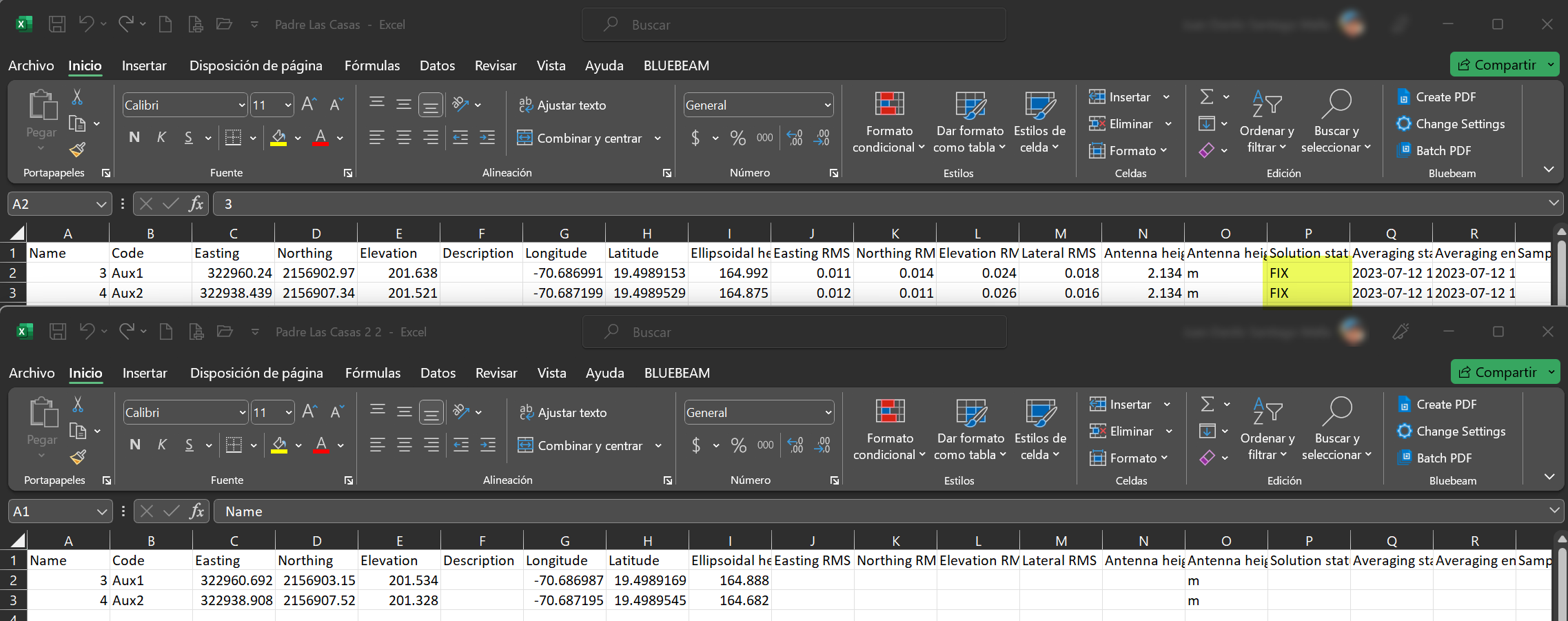

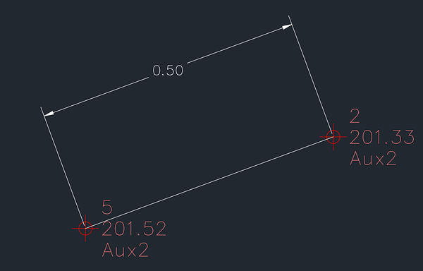

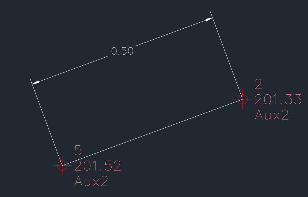

Hi, I could understand you can have difference between RTK and Stop and Go postprocess, but how we can have 50 cm in horizontal and 20 cm in vertical difference in the same point, I think is too much for a precision work, which one is correct?
