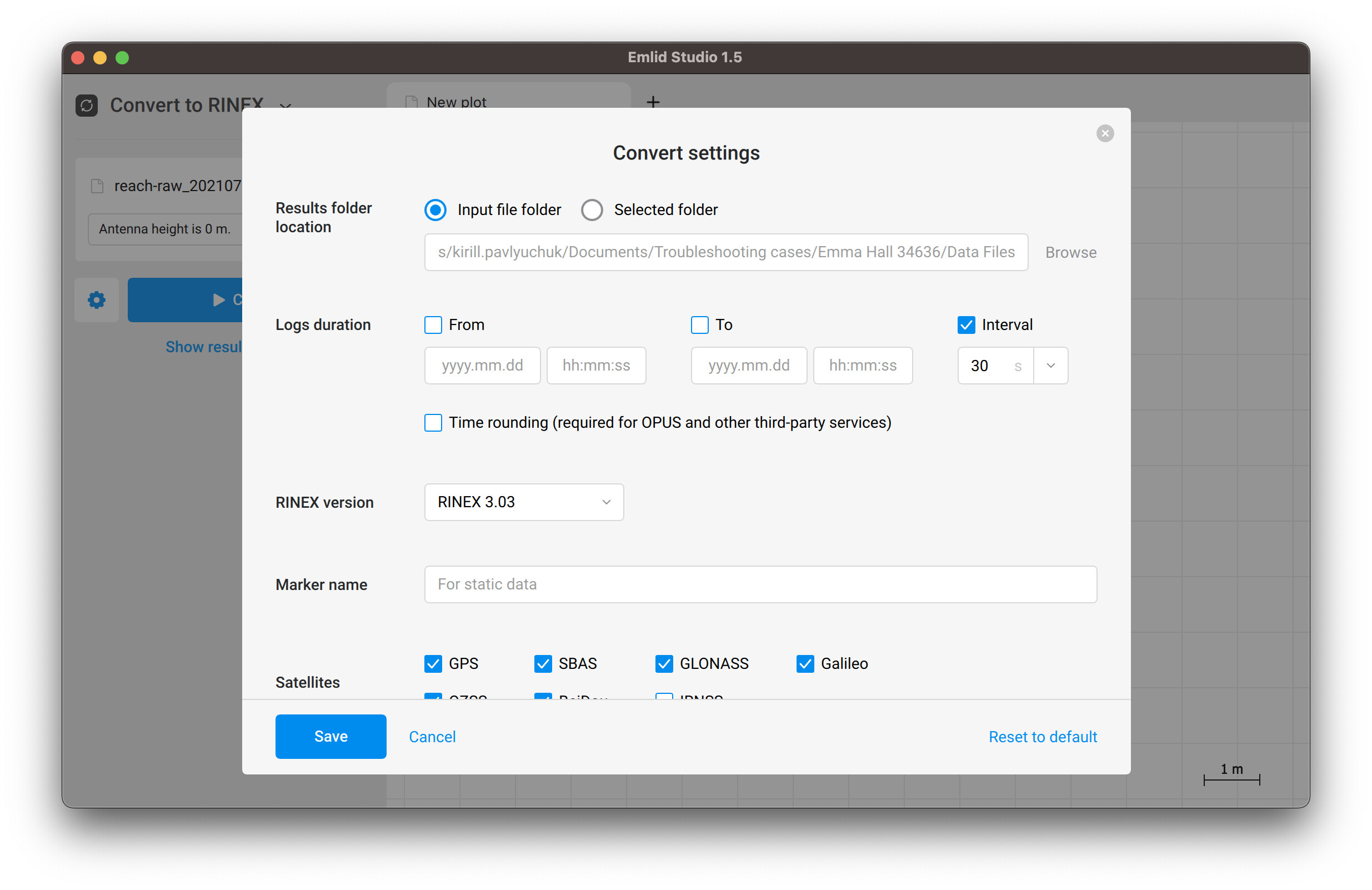

Also, it’s possible to change the interval of the RINEX log in Emlid Studio using Convert to RINEX mode if you have the UBX file as @dpitman suggested:

In the meantime, I’ve converted your log in Emlid Studio with a 30-second interval, and the software fixed the log properly. It was submitted to OPUS successfully, you can find the log and the result in the attached archive.
