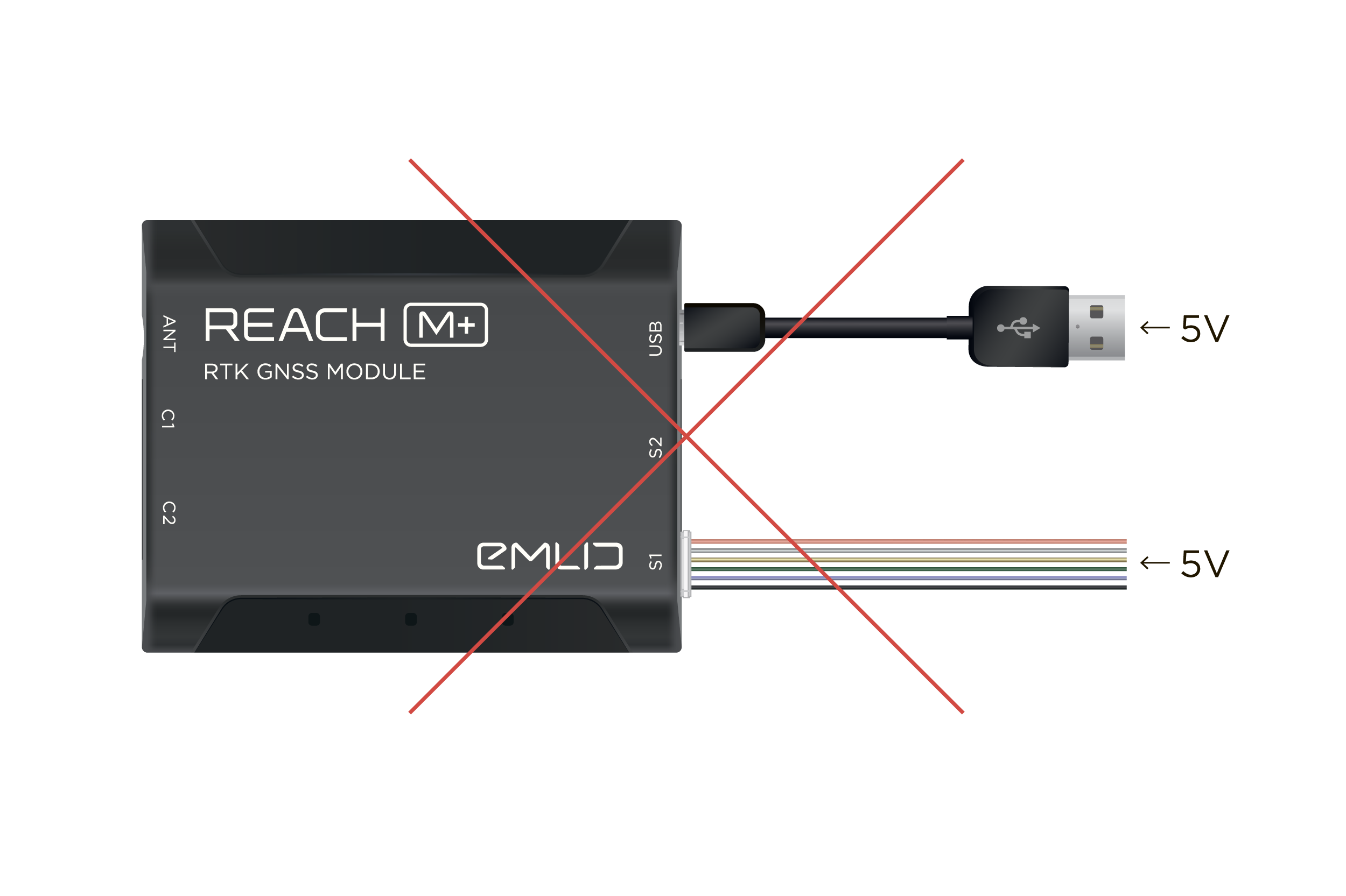

If there is a warm-up time for the receiver, letting the drone sit fully turned on would drain battery from the drone, thus giving you less flight-time.
So instead one would be looking at solution where you could power up the M+, let it get a fix, then startup the drone and switch over the M+ module to the Drone power pack (without turning it off in the process).
Hi @wizprod,
The best solution for that is to power M+ with an external power bank.
Note, that in this case, you’ll need to cut the power wire connected to the drone controller.
Is that to prevent power Noise from the drone systems?
No, to prevent dual powering the device.
