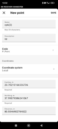

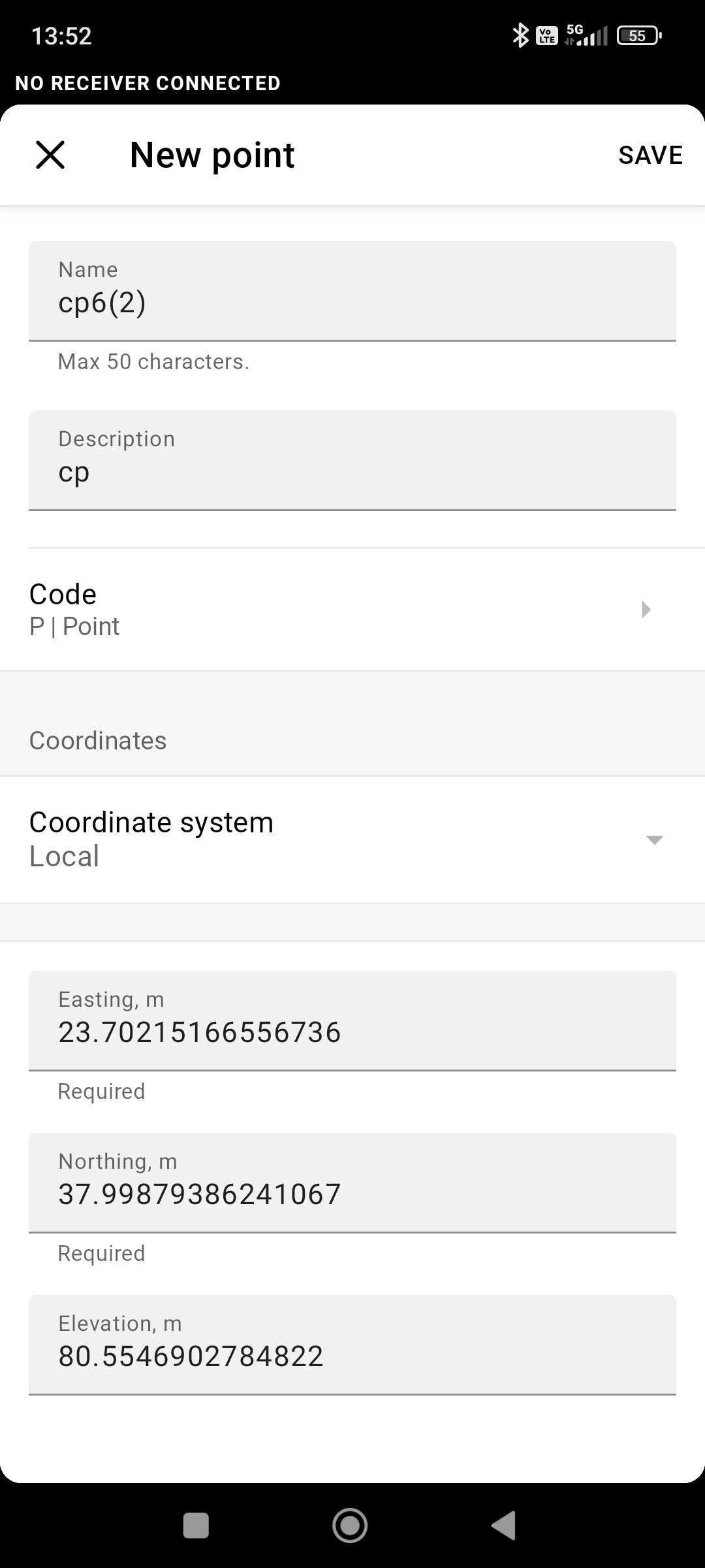

Very nice tool but there is a bug when duplicating a point. Lets say that I work in local coordinates, the emlid flow doesn’t keep these coordinates but only the global.
The Global and Local coordinates are the same number in the duplicated point.
Hi Dimitrios,
Thanks for testing the new feature!
The Duplicate & Edit feature is designed to pre-fill coordinates based on the point’s origin.
In your case, the point was collected using Emlid Flow. Points are usually collected using the global coordinate system and then converted to local coordinates. That’s why the tab has its global coordinates pre-filled. When you save the point, we’ll calculate and update the local coordinates for you.
On the other hand, if the point was manually created or imported with local coordinates already assigned, the local coordinates will be pre-filled.
UPD: Reworded the explanation to make it clearer. Hope this helps clarify things!
