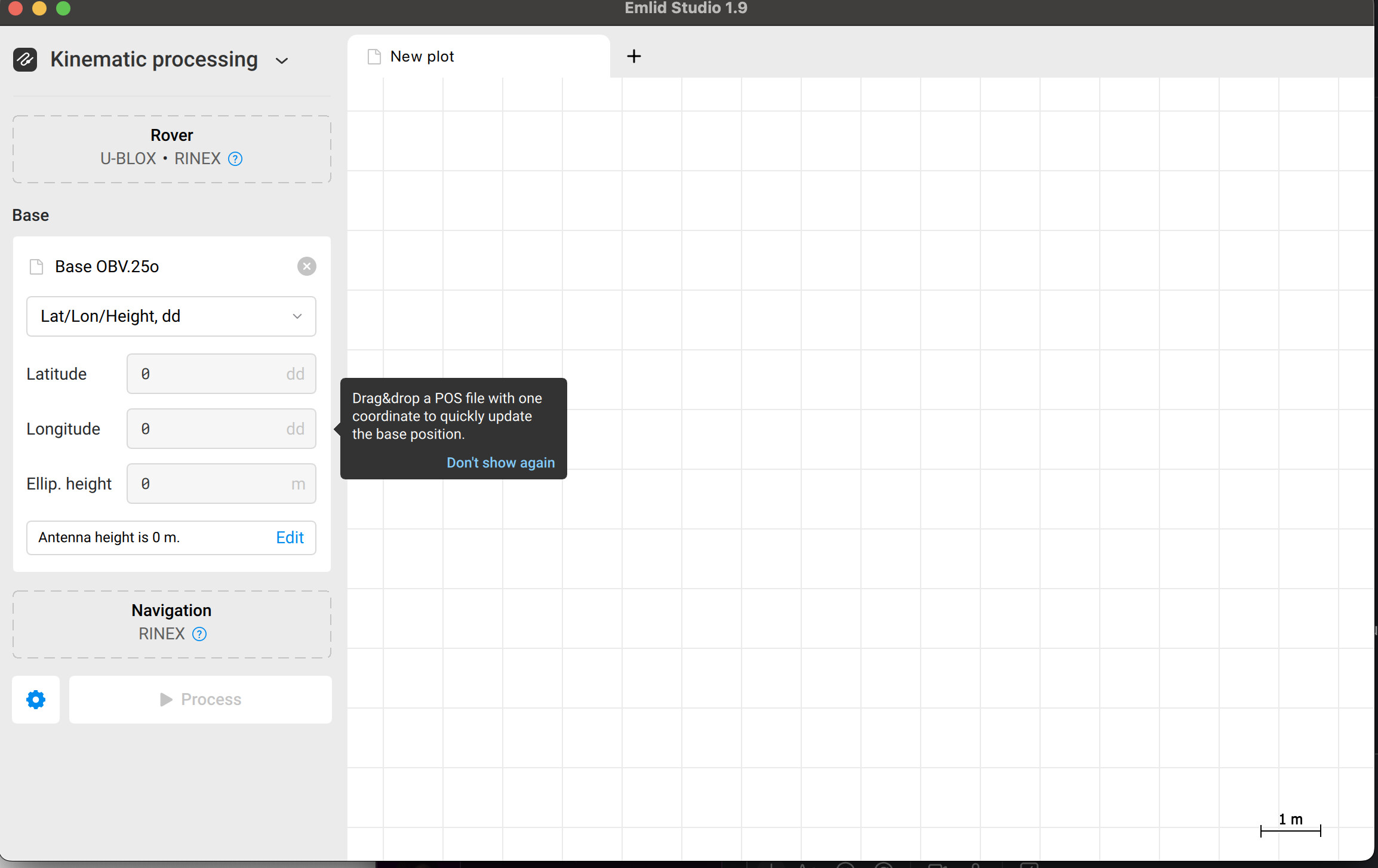

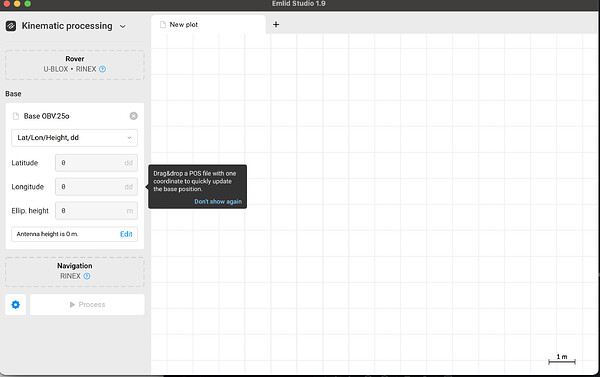

When setting up the base manually by typing in the coordinate, you can calculate the difference between this and the established control point and apply this shift to all the rover coordinates in the CSV. It’s important to ensure that the correct base coordinates are in the same datum as the updated ones.
Also, as @dpitman suggested, you can use Emlid Studio to manually enter the correct base position and run the files in PPK. Upload the base RINEX observation files and change from RINEX Header position to LLH.
Thanks, I essentially did that in AutoCAD by taking the survey points tied to the incorrect base location and transferred that group’s base point to the correct base coordinate location and all looks good. I also plan to post process as well as a confirmation. Thank You both!
