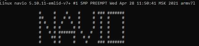

This is my Navio version

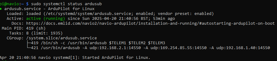

This is the result I get from sudo systemctl status ardusub

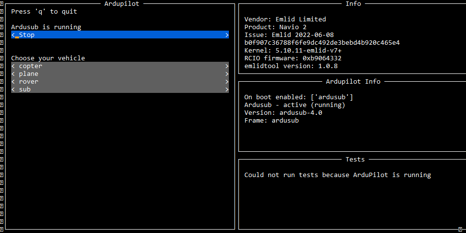

This is what I get from sudo emlidtool ardupilot

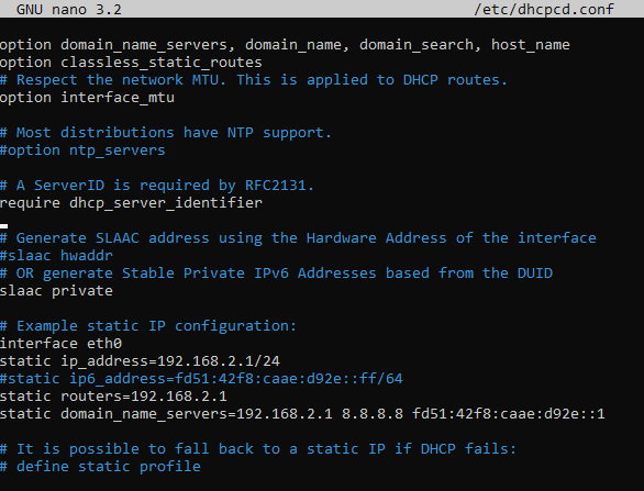

What I have in /etc/dhcpcd.conf
I’m able to get ardusub to initialize, and I was able to reconfigure the Raspbian image to work via a direct ethernet line, but it appears that nothing is being sent back to my Raspberry Pi from my ground control computer. I tried a wireless connection, as well, on another computer, with the same results, so I’m a little mystified as to what the root of the problem is.
I reconfigured both my host ground control computer (the one that I connect to via an ethernet line), and the RPi to use a static IP of 192.168.2.1, but the IP of the ground control computer was reassigned to 169.254.85.55 by its DHCP server. My other computer is on the same wireless network as my RPi, at 192.168.1.40. The RPi itself is at 192.168.1.34 on this network.

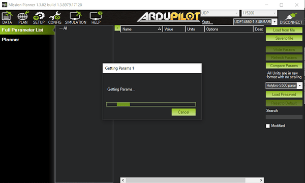

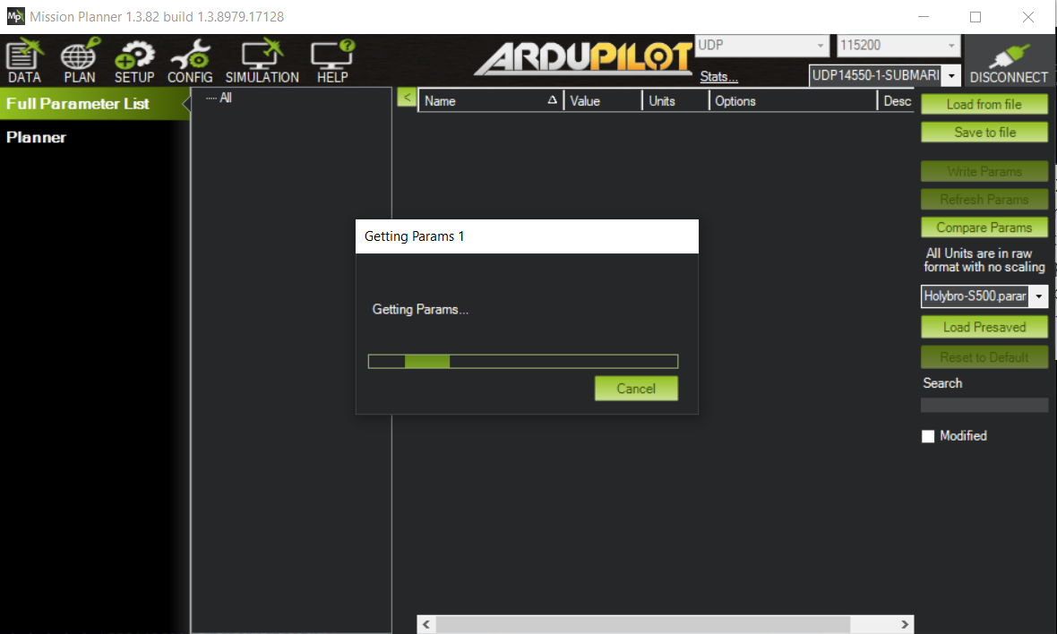

I’m stuck loading parameters whenever I try to connect with mission planner on the direct ethernet line:

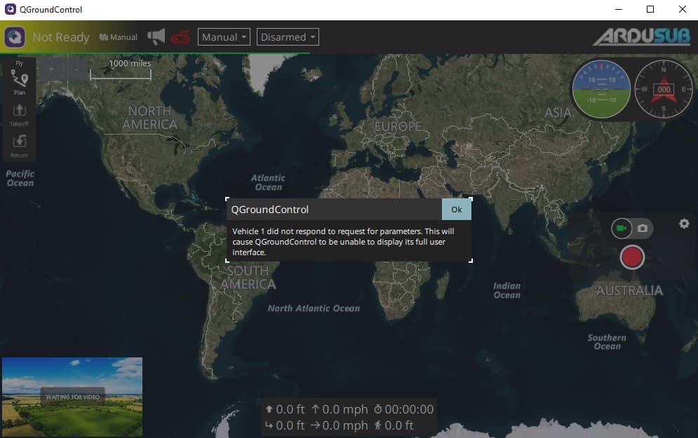

On QGroundControl, the same thing happens, and I get this error:
